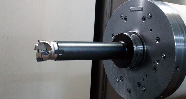

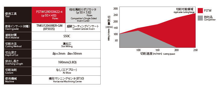

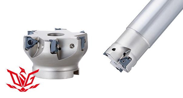

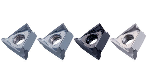

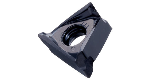

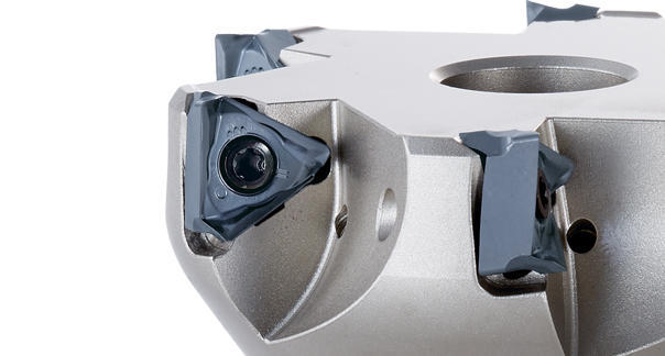

High efficiency 6-corner shoulder milling cutter for heavy-duty cutting. Thick insert and positive rake angle with increased rigidity are resistant to chattering to enable effective processing of long overhang length L/D=5xD. Bore type size 09 has been expanded with φ80 to φ125; size 12 has been expanded with φ50 to φ80. The bore type added to size 12 is compatible with arbors for high feed radial cutters. The addition of DLC coated insert grade XP4610 enables even longer tool life in non-ferrous metal applications.

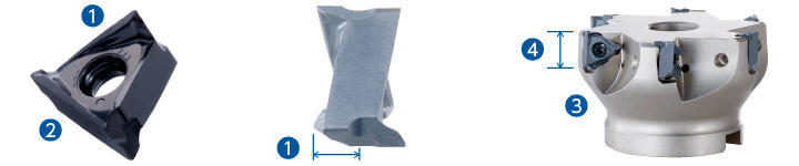

High rigidity and positive rake angle geometry
Economical 3-corner per side (6 corners in total) specification
Body design engineered for high efficiency machining
Maximum depth of cut: size 09 is 7.5mm, size 12 is 12mm
Mild Steel・Carbon Steel・Low Carbon Steel・Alloy Steel・Die Steel・Stainless Steel・Cast Iron・Ductile Cast Iron・Aluminum Alloy・Superalloy(Wet)・Titanium Alloy(Wet)・Pre-hardened Steel・Steel for Die Casting・Hardened Steel
Straight Shank Type (PSTW SS)
- φ25~φ40
Bore Type (PSTW BORE)
- Size 09 insert φ40~φ 125
- Size 12 insert φ50~φ 125
