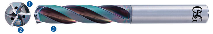

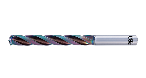

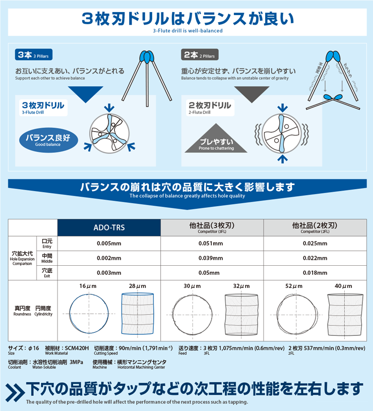

The ADO-TRS’ unique R gash geometry enables high thrust resistance and exceptional chip control, which are common challenges of 3-flute drills. With its low cutting resistance capability comparable to 2-flute drills, it is able to create short and compact chips stably.
Benefits of 3-Flute Geometry
R gash geometry enables low cutting resistance comparable to 2-flute drills and breaks chips into small manageable pieces
Wide chip pocket configuration enables smooth chip evacuation
High durability EgiAs coating

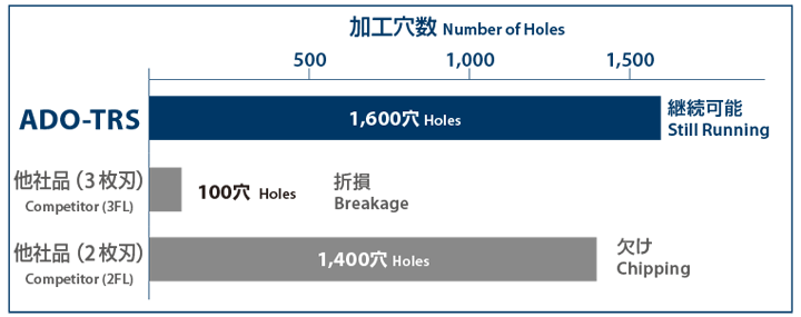

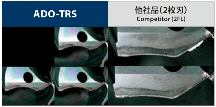

Outstanding cutting chip breakage and consistent chip form
■Chips from the competitor 3-flute and 2-flute drills are elongated and are the common cause of chip evaluation troubles
