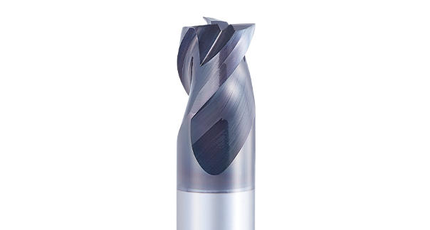

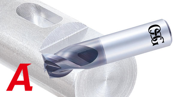

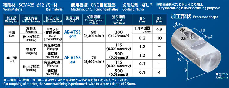

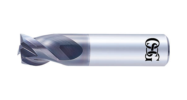

The AE-VTSS anti-vibration carbide end mill is compatible with sliding head lathes and excels in a wide range of work materials from carbon steel, alloy steel, stainless steel to titanium alloy. The AE-VTSS is optimally designed to accommodate CNC sliding head lathes, featuring short overall length and length of cut. With excellent machining accuracy, precision part machining is also possible. The AE-VTSS’ 3-flute specification and bottom cutting edge hook shape contribute to the creation of stable chip shape, improve chip evacuation, and enable uninterrupted machining and automation. Furthermore, by adopting an unequal spacing of teeth and variable-lead geometry, multi-functional and highly efficient machining with sliding head lathes is realized.
Anti-Vibration Carbide End Mill Compatible with Sliding Head Lathes Features
1 "DUARISE coating" provides excellent lubricity, superior friction-resistance and high oxidation temperature

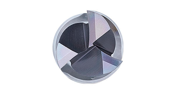

2 3-flute specification and bottom cutting edge hook shape (PAT. P. in Japan) optimized for a wide range of machining including plunging
3 Variable-lead geometry suppresses vibration

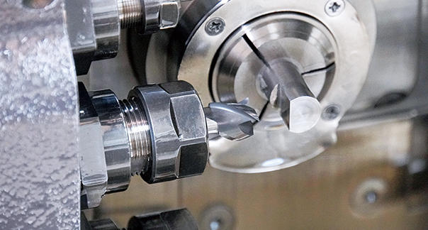

High efficiency machining with sliding head lathe
