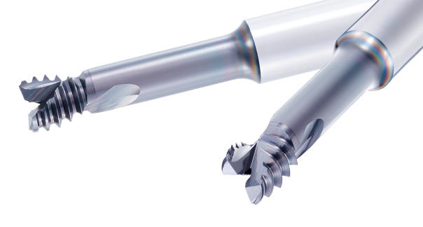

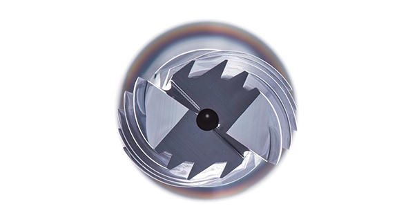

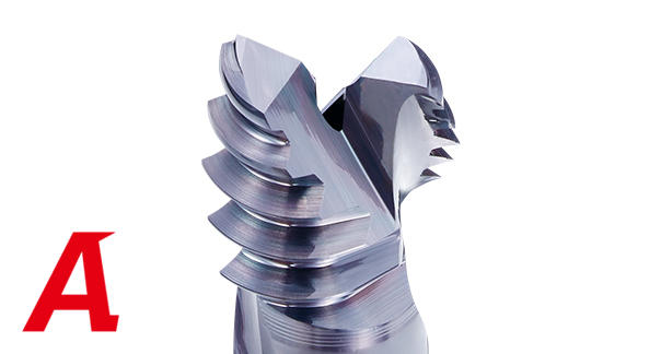

The high-efficiency thread mill AT-2 R-SPEC (ThreadRacer) is engineered to dramatically reduce machining time in non-ferrous metal applications such as aluminum alloy by its continuous helical cutting ability, which combines drilling and threading into a single process. The AT-2 R-SPEC is also effective as a countermeasure against cutting position misalignment in cast holes.
High-efficiency thread mill with end-cutting edge for non-ferrous metals Features

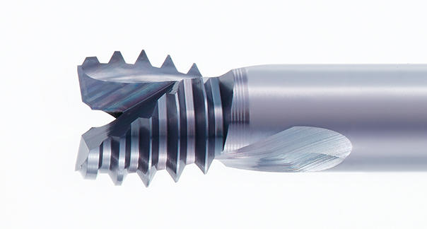

  • Helical drilling + threading can be done simultaneously.
Threading time can be dramatically reduced

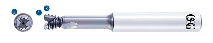

  • DLC-IGUSS coating
1 Left-hand cut configuration enables climb milling to prolong tool life
2 Superior chip evacuation *Tool DC = φ4.6 or more
3 Special cutting edge shape suppresses bending of the tool

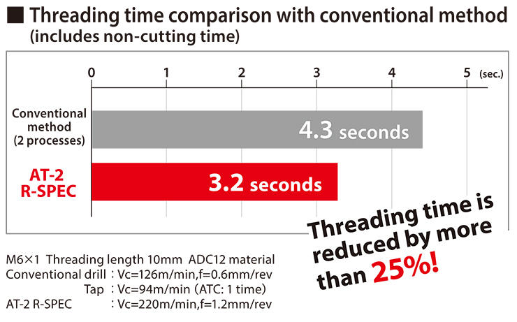

Threading time comparison with conventional method (includes non-cutting time)
