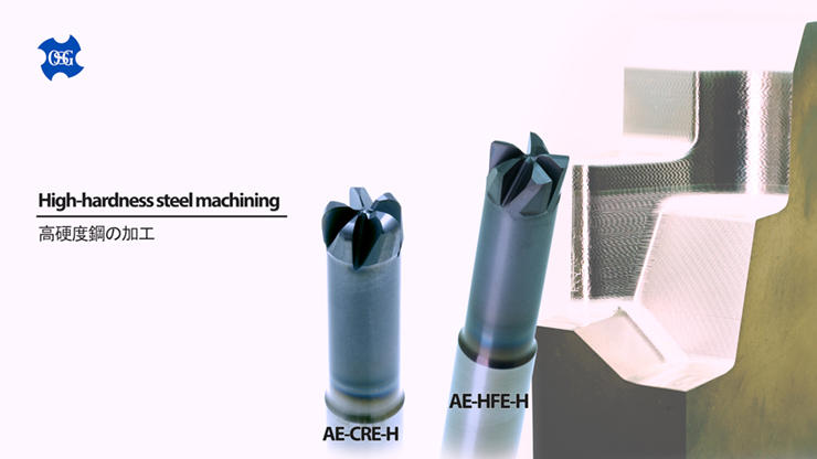

AE-CRE-H・AE-HFE-H

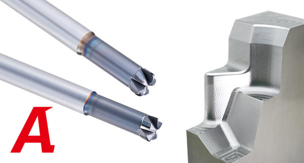

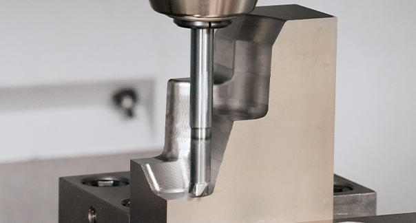

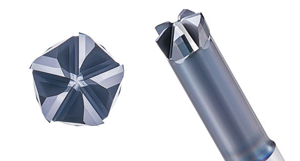

DUROREY coating enables superior heat resistance and high toughness optimized for high-hardness steel milling!

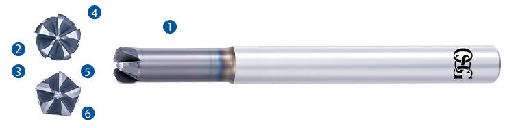

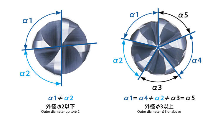

Achieves high-efficiency milling with multi-flute and unequal spacing teeth specifications

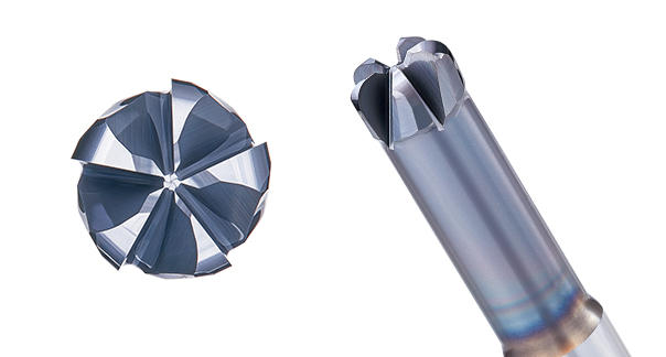

Two-stage gash shape that achieves both cutting edge strength and good chip evacuation

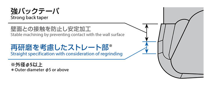

Straight specification with consideration of regrinding
AE-CRE-H: Cutting edge specifications that enable highly efficient direct engraving

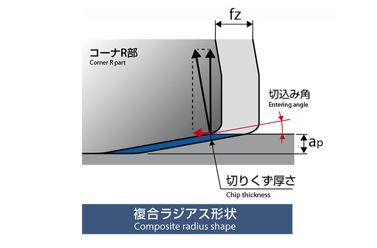

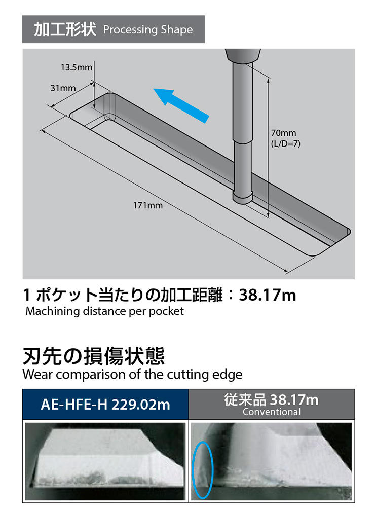

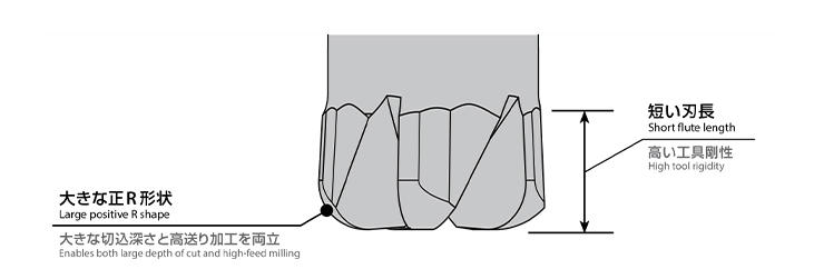

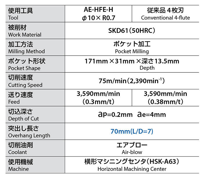

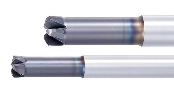

AE-HFE-H: Reduces cutting resistance with unique composite radius shape. High-speed, high-feed machining is possible at overhang length of L/D = 7
High Efficiency Type (AE-CRE-H)
- 1×R0.2~13×R3
High Feed Type (AE-HFE-H)
- 1×R0.1~12×R08
