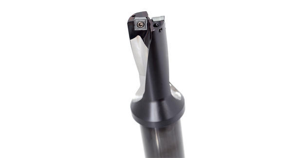

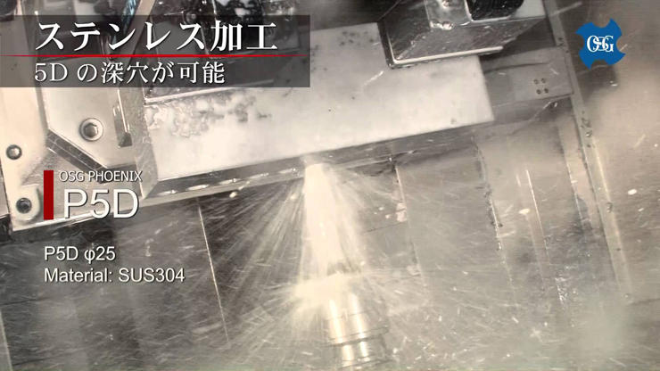

The indexable PD series features an optimized flute geometry at the tip of the cutter body with excellent surface smoothness to enable superior chip evacuation. It is an ideal solution for a wide variety of materials such as carbon and alloy steel, stainless steel, cast iron, and non-ferrous materials.
Indexable Drill Features

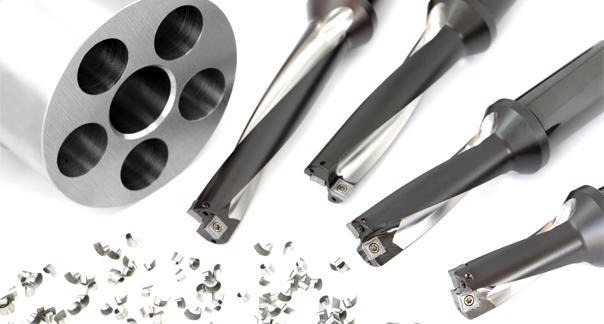

1 Optimized groove on the body tip helps to lead chips to the flute smoothly.
2 High precision finishing of flute improves rigidity, chip ejection and reduces cutting force.

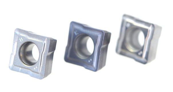

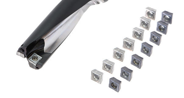

3 Economical 4-corner insert design maximizes cost efficiency, with the same insert applicable to both center and peripheral cutting edge.
→The peripheral insert is recommended for maximum durability!

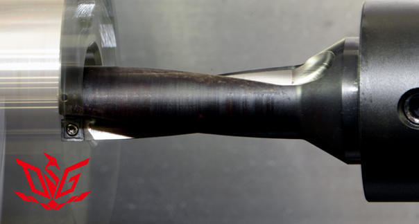

4 Internal coolant system enables highly efficient drilling.
5 High- feed drilling made possible by sequential balance of inserts.

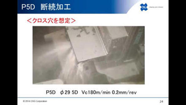

Achieves stable drilling, even when making rigorous, 5xD deep holes
