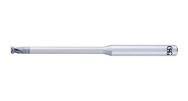

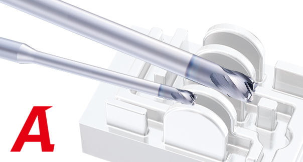

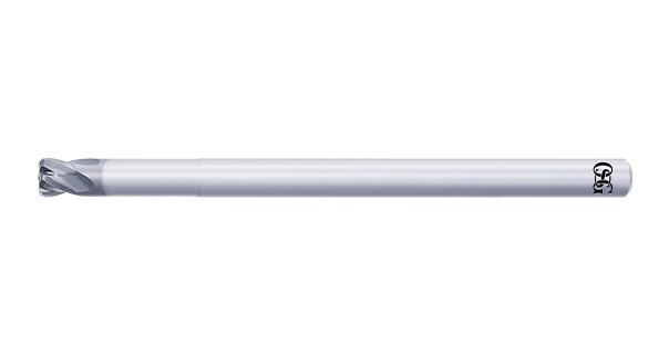

The AE-CPR4-H is a long neck corner radius carbide end mill engineered to achieve high-efficiency and high precision milling in high-hardness steels. All sizes are available in the 4-flute configuration for maximum productivity. OSG’s DUROREY coating for high-hardness steel is employed with high chipping resistance even for work materials exceeding 60 HRC, enabling long tool life and high-speed machining.

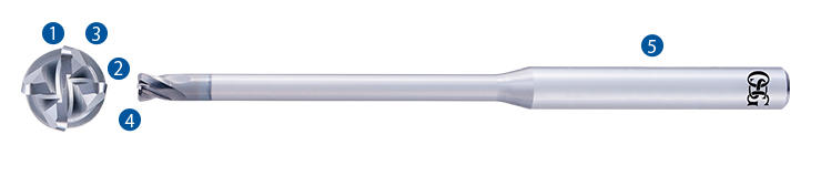

  • Newly developed DUROREY coating enables superior heat resistance and high toughness optimized for high-hardness steel milling!
1 Achieves high-efficiency milling with 4-flute specification
2 The new gash specification with a spiral shape improves chip evacuation and prevents chips from getting caught
3 Unequal spacing teeth suppresses chattering
4 Superior ball corner R precision ±0.005
5 Superior shank accuracy. Supports h4 tolerance (0/-0.004)

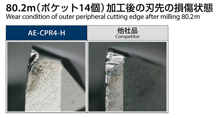

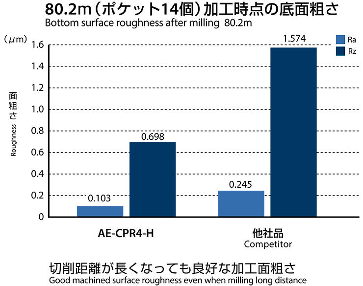

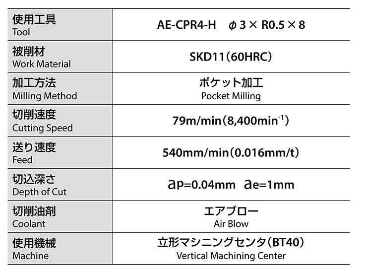

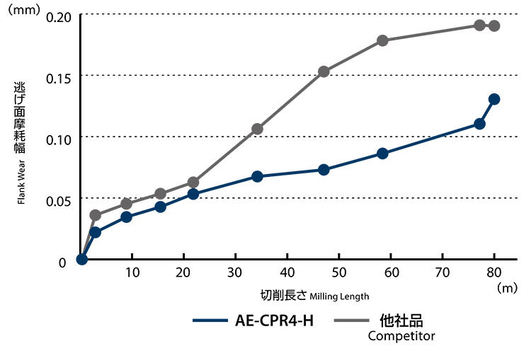

Achieves excellent durability and machined surface accuracy in profiling of high-hardness steel
