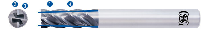

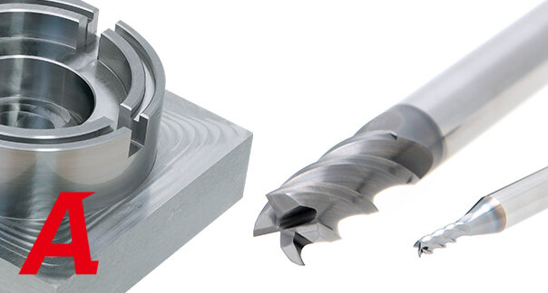

The AE-VM anti-vibration carbide end mill series offers extensive material compatibility, ranging from carbon, alloy, and stainless steels to titanium and Ni-based alloys. For improved chipping resistance, the AE-VMSX incorporates a reinforced cutting edge with microrelief and edge honing. Furthermore, the integration of the “DUROREY” coating specifically for high-hardness steels (up to 50 HRC) provides superior chipping resistance, contributing to extended tool life and high-speed machining. The lineup now includes corner radius and long-neck corner radius types, offering greater flexibility for a wider range of machining applications.
DUROREY coating with high heat resistance and high toughness optimized for machining high-hardness steel

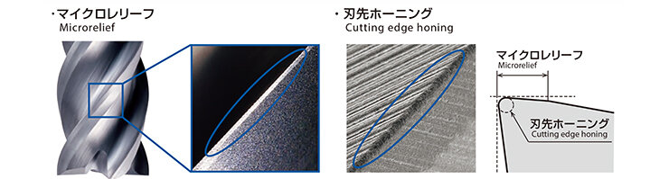

Microrelief and cutting edge honing increase the strength of the cutting edge and improve chipping resistance

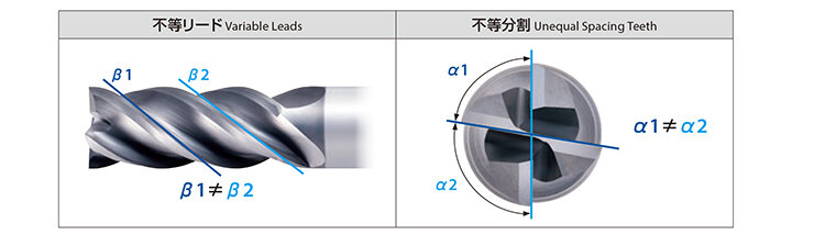

Unequal spacing of teeth and variable-lead geometry suppresses the occurrence of chatter vibrations

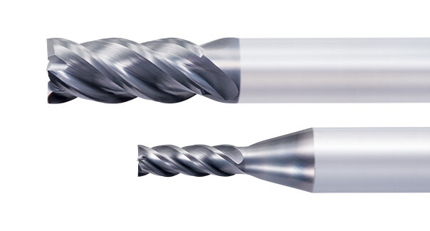

The web taper geometry, where the thickness of core changes from the cutting edge to the shank, greatly improves tool rigidity

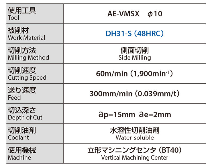

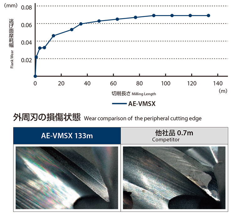

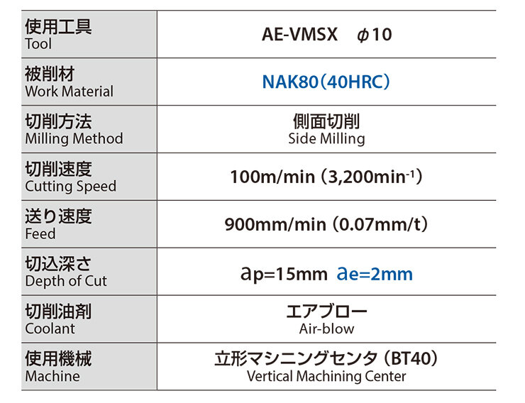

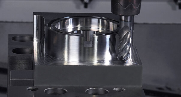

Stable machining even in hot die steel DH31-S

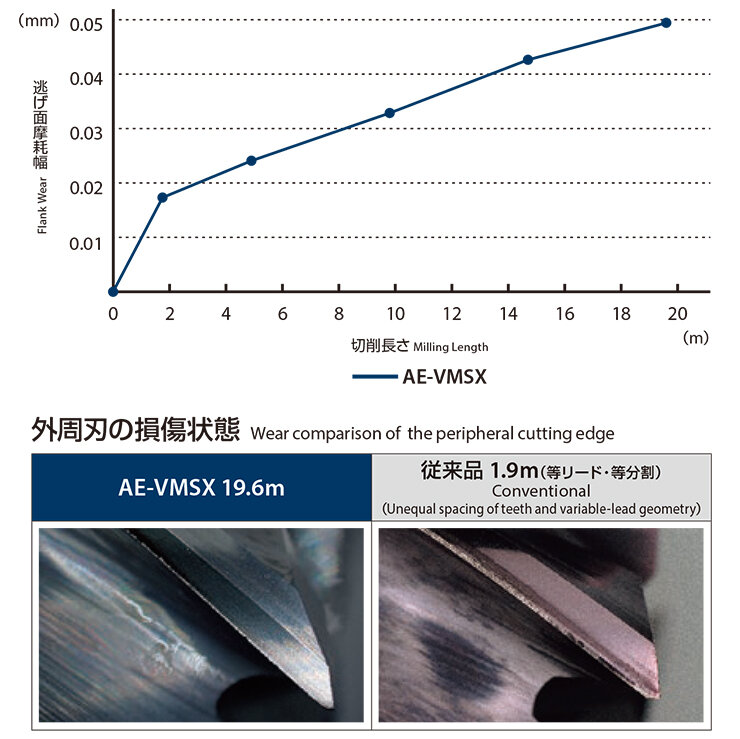

Strengthening the cutting edge with microrelief and cutting edge honing achieve stable wear progression without chipping even during deep cuts. Longer tool life contributes to reducing waste and conserve resources.
