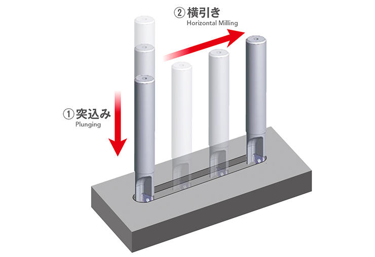

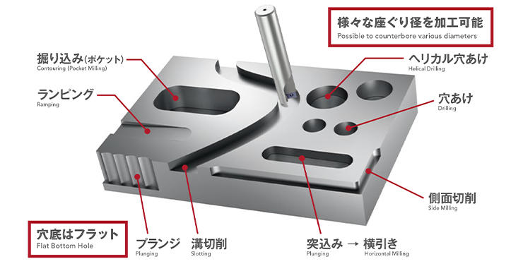

The PMD is a versatile multi-function cutter that enables continuous cutting from plunging to horizontal milling. This indexable series supports a wide range of applications with a single tool and is suitable for processes such as contouring, ramping, helical drilling, the drilling of flat bottom holes, and more. Additionally, stable and trouble-free machining is made possible by the PMD’s excellent chip breaking capability.
Supports a wide range of applications with a single tool

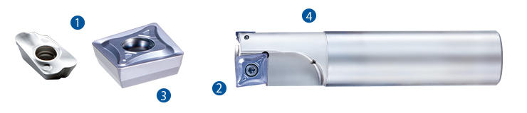

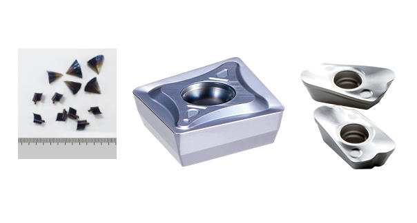

1 Two types of inserts are used to enable continuous cutting - from plunging to horizontal milling

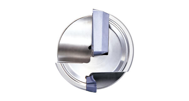

2 Enables the drilling of flat bottom holes
3 Superior chip breaking capability during drilling and plunging
4 Excellent chip evacuation by internal coolant

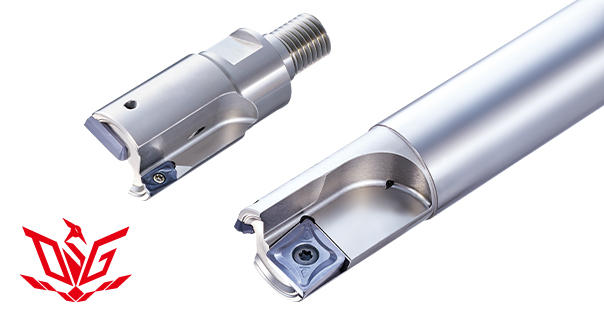

Straight Shank Type
  • φ16~φ32
Screw Fit Type
  • φ16~φ32

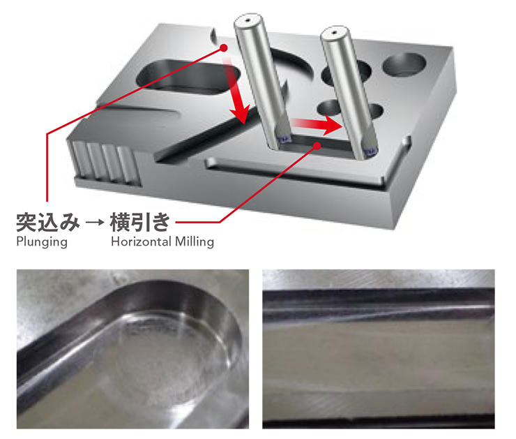

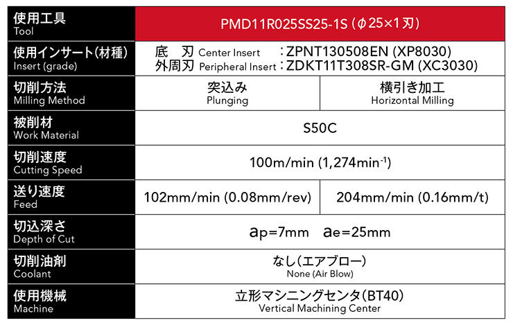

Achieves good machined surface without chattering from plunging to horizontal milling
Excellent milling surface finish without chattering.
Excellent milling surface finish without chattering1
Excellent milling surface finish without chattering2
