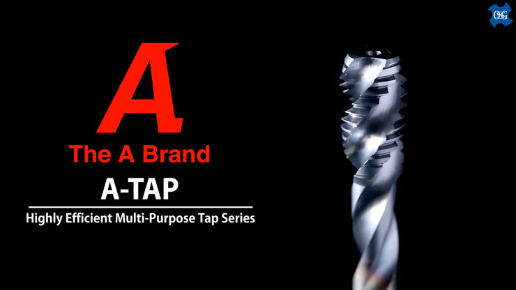

The A-Tap is known for its superior chip evacuation capability. It is an all-purpose tap series developed to accommodate a wide variety of materials and machining environments, helping manufacturers simplify tool management. Looking for a reliable tool that can do it all for general threading? The answer that you have been waiting for is here.
High Efficiency Multi-Purpose Tap Features
1 Sharp cutting edge stabilizes chip shape.
2 Variable lead flute enables trouble-free chip evacuation.
  • Excels in a wide range of applications and materials.
  • Compatible with various types of machining equipment – from manual drilling machines to the latest advanced machining centers.
