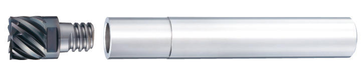

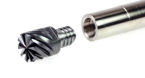

The PXM is an exchangeable head end mill series with the same high performance of a solid tool and the cost efficiency of an indexable tool. A single exchangeable head body is able to accommodate a wide range of exchangeable heads to meet various application needs.
- Offers performance advantage of both solid and indexable tools.
- A single shank holder to accommodate a wide variety of exchangeable heads.
- Comprehensive exchangeable head lineup for various applications. New PXSH exchangeable heads for high-hardness steels.
- Prevents clogging of chips by using coolant or air through the internal oil hole. Improves chip evacuation.
- The outer diameter of the large flute type is larger than the shank neck diameter, making it highly effective in processing of die and mold applications that require vertical wall milling or pocketing.
- Collet for PXM (PXMC) : Enables ultra efficiency even on small machining center.
