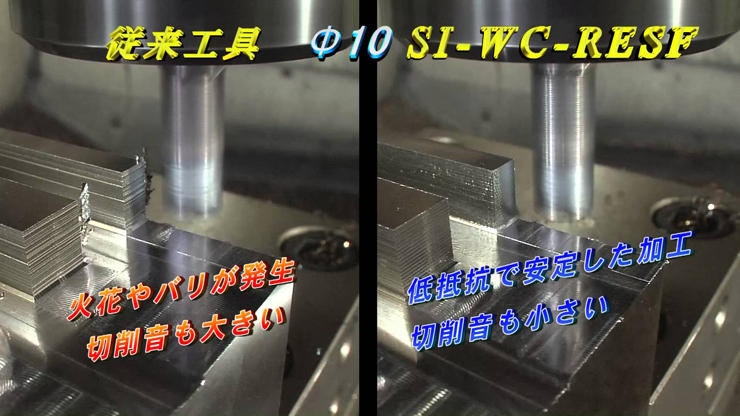

OSG’s Silent Roughing end mills feature nicks along the cutting edge that act as mechanical chip breakers to produce shorter, more manageable chips. Typically used in roughing applications where deep depths of cut and low horsepower machine capability are present.

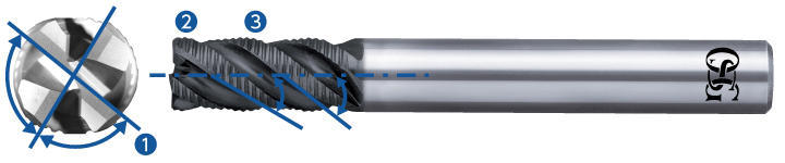

End Mill Features
1 Variable-lead geometry suppresses vibration.
2 Enables low cutting resistance.
3 WXL coating for long tool life in a wide range of materials and machining environments.

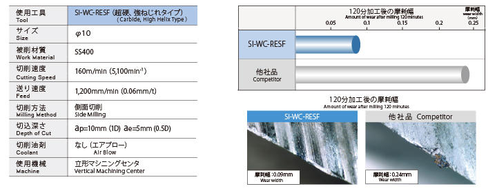

Tool wear of SI-WC-RESF is less than half of the competitor’s product.
