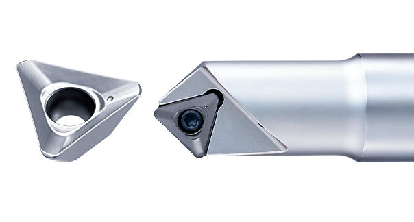

The PLDS indexable cutter can be used for centering, chamfering and V slotting with a single tool. Its economical 3-corner triangle insert combines chipping resistance and sharpness. Two high-strength insert grades can be selected according to the work material – for steel and cast iron or for stainless steel and heat resistant alloys.
Centering, countersinking and V slotting can be performed with a single tool

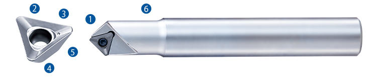

Centering and Chamfering Cutter Features

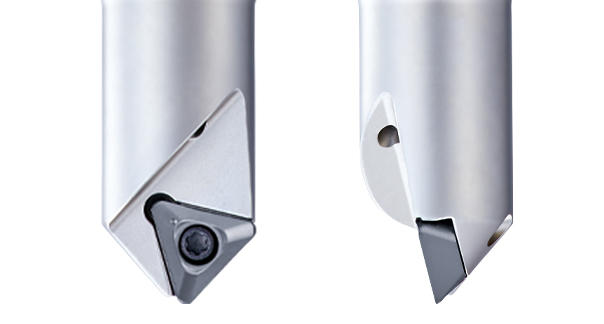

1 Two types of bodies are available -SIG: 90° and 120°
2 Economical 3-corner insert design maximizes cost efficiency
3 High-strength insert grades that can be selected according to the work material
4 Highly rigid negative chamfer tip that enables difficult centering operations
5 Large rake angle and low resistance
6 Internal coolant contributes to stable machining

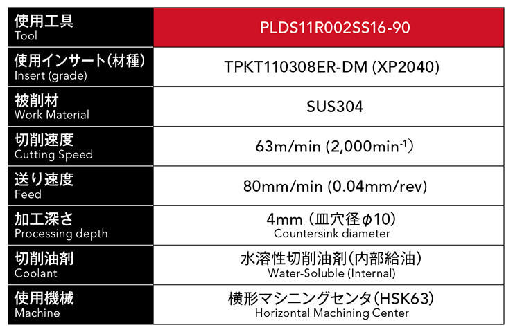

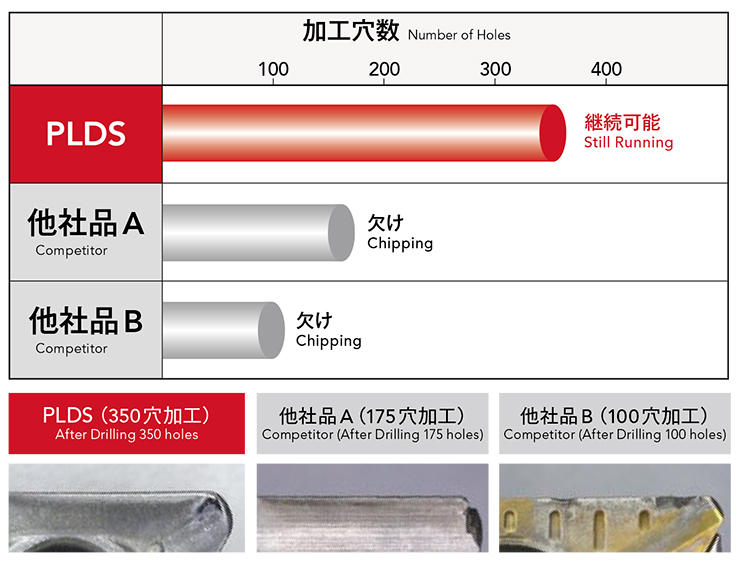

90° centering
The PLDS exhibits good wear condition and can continue to be used even after machining more than twice the number of holes as the competitor products.
