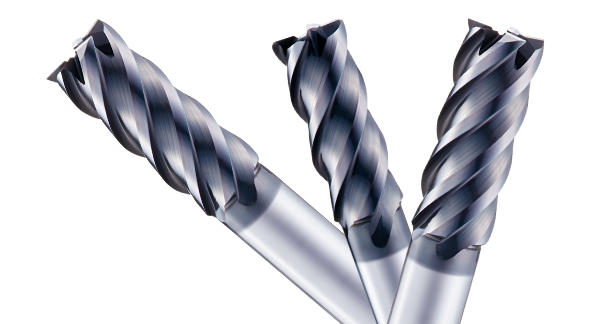

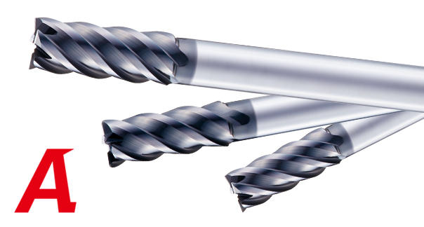

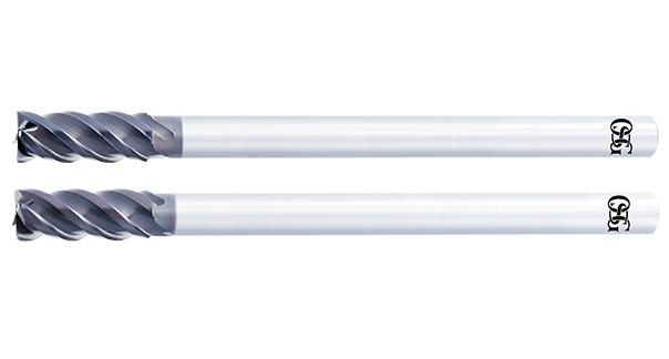

The AE-VM anti-vibration carbide end mill series is engineered to excel in a wide range of materials including carbon steel, alloy steel, stainless steel, titanium alloys and Ni-based alloys. The AE-VMFE for deep side milling has been newly added to the lineup. Deep side milling at L/D of 5 x D or more can be machined with high efficiency and high accuracy by large step milling up to 2 x D with its 2.5 x D cutting length configuration.
Details on DLC Coated Carbide End Mill for Non-Ferrous Materials High Performance Type for Deep Side Milling(AE-VTFE-N)
Anti-Vibration Carbide End Mill for Deep Side Milling Features

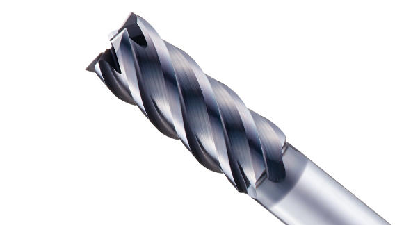

1 "DUARISE coating" provides excellent lubricity, superior friction-resistance and high oxidation temperature
2 Sharp positive rake angle reduces cutting force
3 The long length reduced shank type supports deep side milling and pocket milling of mold parts, etc.
4 High efficiency and high accuracy deep side milling can be achieved by large step milling up to 2 x D with the 2.5 x D cutting length configuration
5 With an R shape on the shank side edge, streak generation can be suppressed by side step milling
6 High anti-vibration effect by the combination of variable lead, unequal spacing teeth and microrelief geometry
