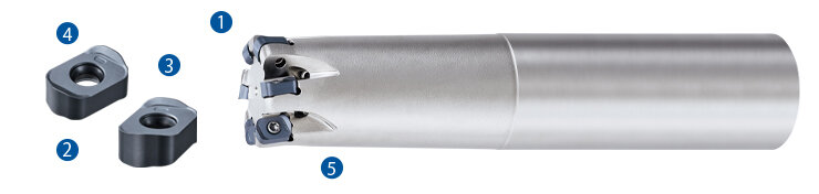

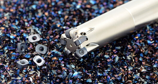

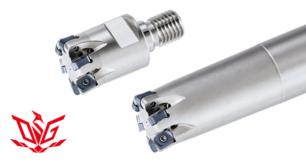

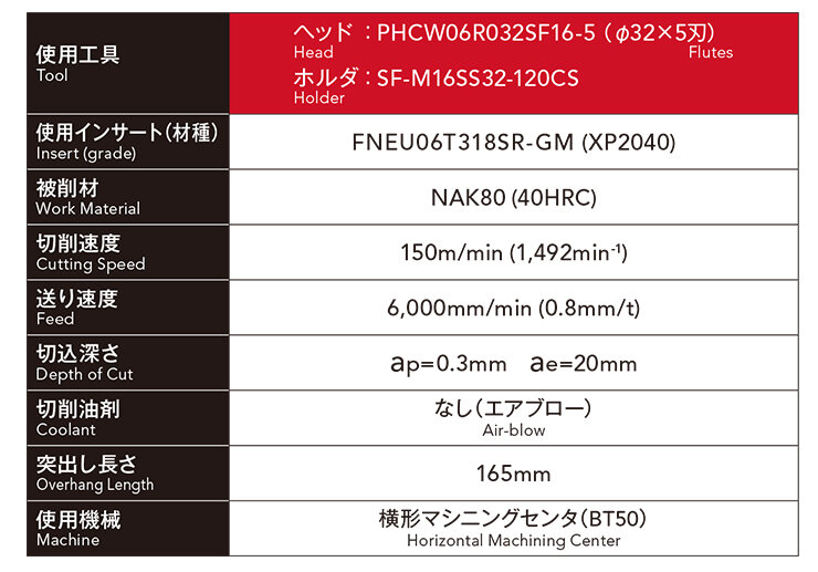

The PHCW double‑sided high‑feed radius cutter significantly reduces mold roughing time, delivering outstanding cutting‑edge strength and superior chipping resistance. The multi‑insert body boosts machining efficiency, while inserts engineered for high toughness and low cutting resistance provide stable, high‑performance roughing—even in demanding conditions such as intermittent cutting and long overhang applications. The double‑sided, four‑corner insert design enhances cost effectiveness and helps reduce overall running costs. The lineup includes straight‑shank (Ø16–Ø32) and screw‑fit (Ø16–Ø40) types. When used with a dedicated shank holder, the screw‑fit type supports machining applications requiring extended reach.
Double-Sided High-Feed Radius Cutter Features

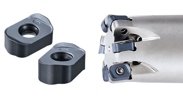

1 Large simulated radius improves resistance to chipping
2 Thick, high‑rigidity insert for stable cutting performance
3Chip breaker with a large rake angle reduces cutting resistance
4 Economical double‑sided, four‑corner design lowers running costs
6 Cutter body with coolant holes to improve chip evacuation
  • Multi‑insert configuration available to further increase machining efficiency
Mild Steel・Carbon Steel・Low Carbon Steel・Alloy Steel・Die Steel・Stainless Steel・Cast Iron・Ductile Cast Iron・Superalloy(Wet)・Titanium Alloy(Wet)・Pre-hardened Steel・Steel for Die Casting
Straight Shank Type
  • φ16~φ32
Screw Fit Type
  • φ16~φ40

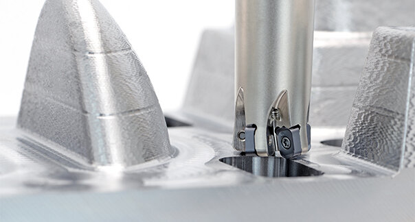

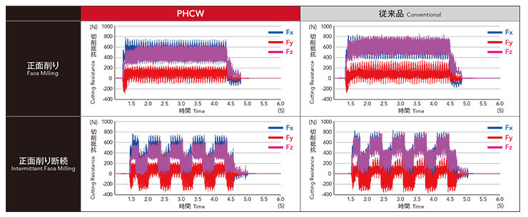

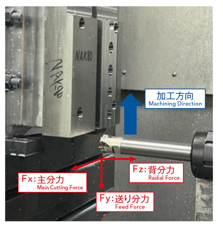

Reduced cutting resistance for stable machining
PHCW delivers consistently low cutting resistance, even at L/D = 5D machining, enabling highly reliable operations.
